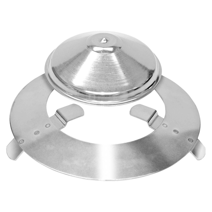

David--
You don't have a grill on your boat? If you have a Magma, you can add a burner plate that allows the grill to be used as a single burner stove top:
Other grill manufacturers have similar arrangements.
And adding a gimbaled one-burner cooker can be a real attribute in bad weather. See Forespar Hot Spot Propane Mini Galley with Coffee Pot
