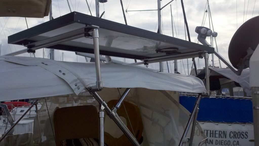

Here is part of the project. We are installing cross supports etc now.
[IMG]Photobucket[/IMG]
One of two 135 watt panels going up. Also a 85 watt is going up there.

I think you will be fine and if you treat it with something like spotless stainless which will passivate the surface there should not be any surface staining issues
As far as strength if the 304 VS 316 was and issue then the design was cutting things a bit close

304 is actually a bit stronger than 316 so you don't need to worry about it. They are both plenty strong for your application.

316 is harder than 304 therefore more brittle. 304 is a bit more susceptible to corrosion but either one is sufficiently strong for your appliaction .....
