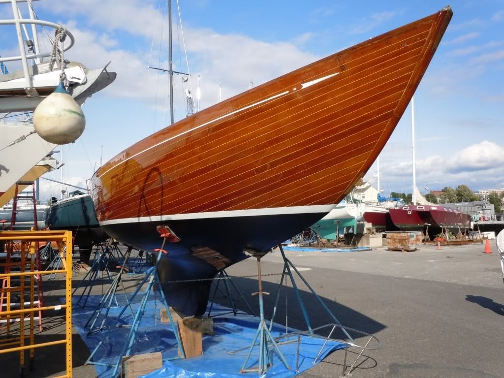

Though most everyone here has seen this:
for those varnish freaks like me... Twenty coats, hand rubbed....
Baggett and Sons Marine Restoration
Charlie - does your mother know that you are a boat pornographer?
Is that sprayed or brushed? Do you thin the varnish? Add Penetrol? Do you do it like high end car paint - wet sand to 600 and then buff? Anything else?
The wood was prepped with 400 and then the first six coats were brushed heavy, sanded back and the rest sprayed with sanding between every fourth coat. Yes, Penetrol was used. No thinning other than what's necessary for spraying using T-10. No wet sanding but she was buffed.
