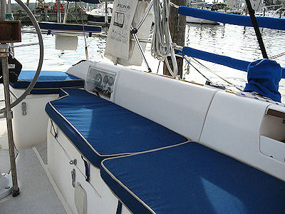

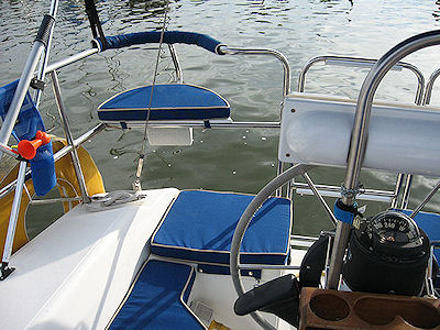

We used Sunbrella for the tops and 2" dry fast foam. Phifertex for the bottom to prevents water collecting in the cushions.
They're held in place with snaps and we leave them snapped in place all summer. They're two years old now, and the only maintenance is a quick scrub with a brush and some boat soap now and then.
The foam is a little stiff but they're a lot more comfortable than the old vinyl cushions. Plus we're not hauling cushions in and out of the boat every time we get there.
