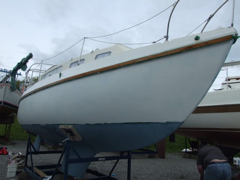

Hello all.
I'm considering changing Serenity's side color from white to scarlet. I know absolutely nothing about gel, other than it being expensive from what I hear.
Can anyone give me a little advice on how to choose a paint (gel) and also approximately how much it takes? 25' long, 8' beam.
Also, is this a multi-coat process like painting a house?
Thanks all.

Break, it's a little like painting a house, but different. It's a lot of gruntwork and preparation and occasional frustration, but well worth it in the end. I'm assuming you are talking about painting the side of the hull (aka "topsides") and not the side of the cabin.
Gelcoat is not the direction I would take for a colour change by an amateur.
Get Don Casey's "Sailboat Refinishing" Read it at least twice before starting on your boat, even before buying materials.
http://www.amazon.com/Sailboat-Refinishing-Don-Casey/dp/0070132259
SWMBO and I refinished Whiskeyjack two years ago , topsides, bottom paint, deck, cabin and brightwork in less than 2 weeks and under $500.

BLJones - WOW, she's beautiful!
So maybe not a color change then, since this will be a DIY project. But here's my situation -
She's not shiny, and she's chalky. Like touching old aluminum siding on a house. I would love to see some shine on her, I think it would completely change the appearance of the boat.
I can live with white, I just figured since I was going to paint her, why not. If there are other or better options, I am more than happy to hear them.
