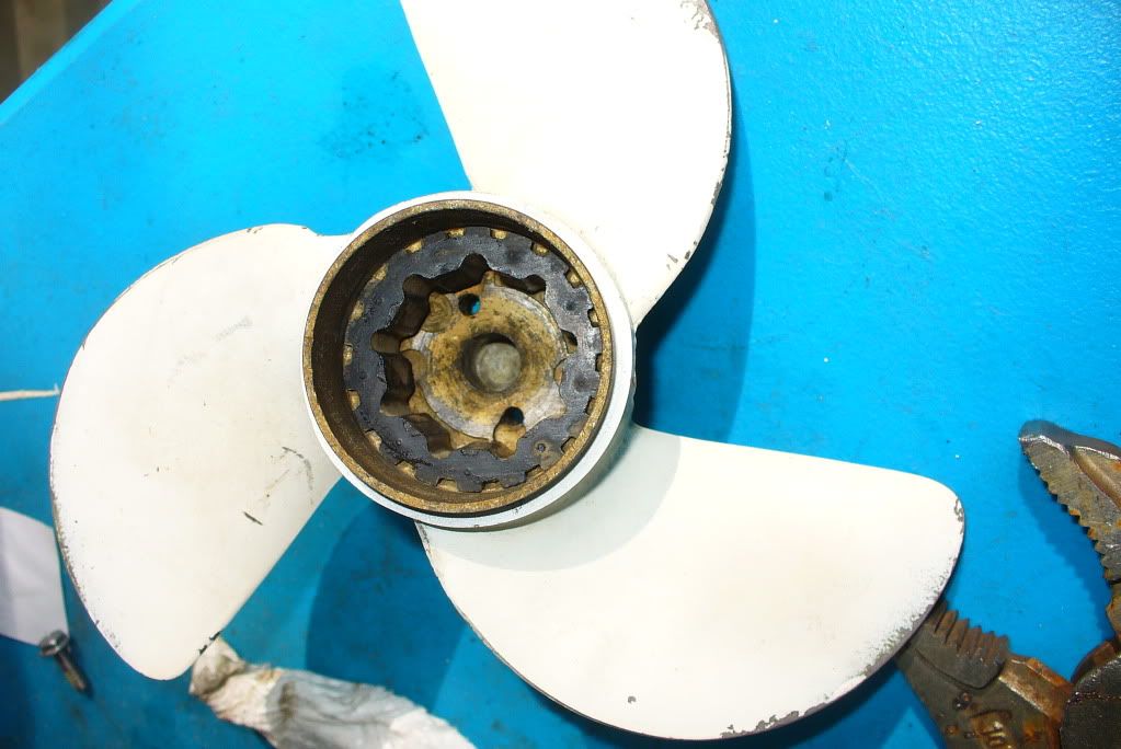

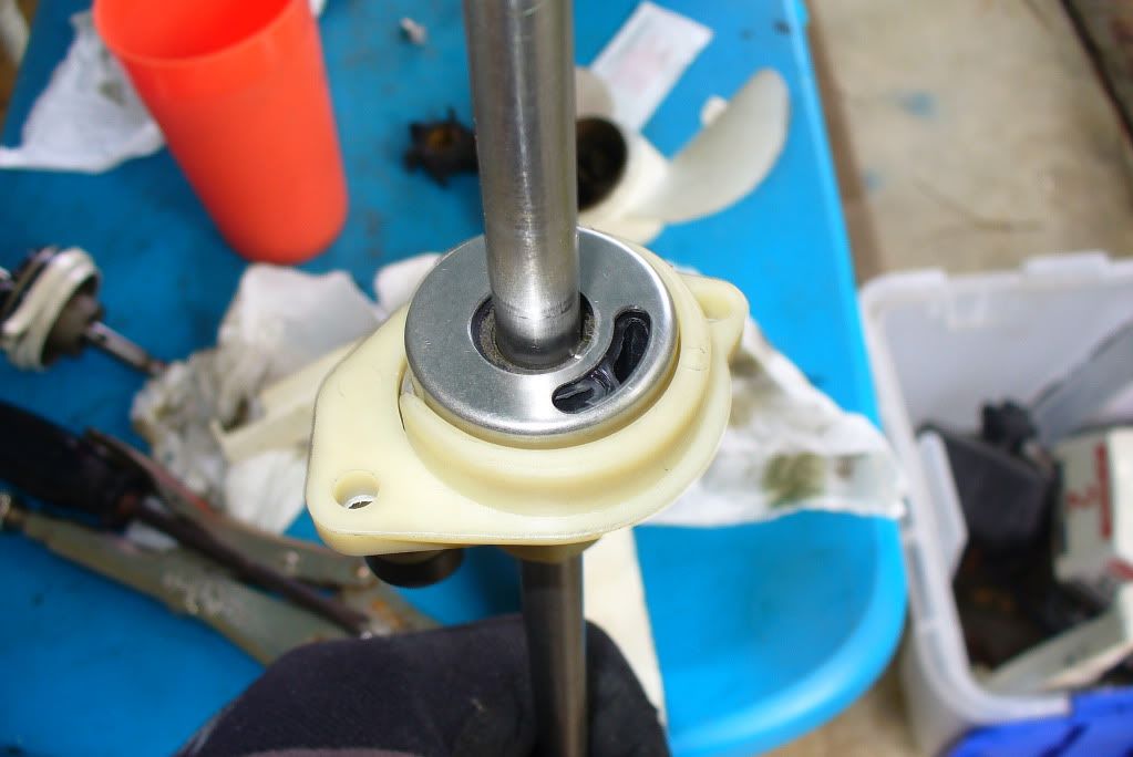

When in gear, only turn the prop by hand in the direction it will turn when running in gear. Otherwise you may damage water pump fins. They're a pretty tight fit and can break off on an older pump. This one should only be turned counterclockwise:
On a Johnson, the prop spinning could be the rubber clutch (called spun hub), or a shear pin breakage. The shear pin would make it so spins really easy whereas the spun hub would usually offer some friction. Here's a look at the rubber clutch on mine:
and the white plastic teeth it engages with when mounted:
