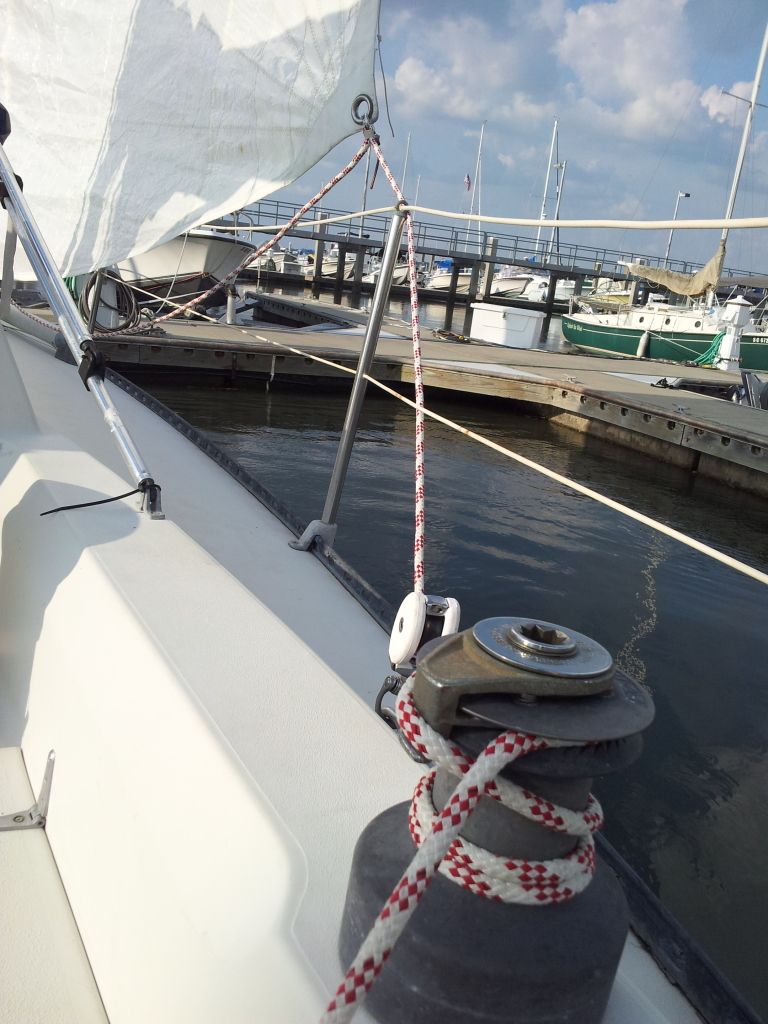

Thanks again for all the impute, I think I will hold off for the time being. I do thing they are a bit saggy. I don't see much in the way of rust. Mine are coated with the white covering. There are no turn buckles. There is only one clip at the stern on both sides to take it loose. That hook is were you would tighten it up. It has no room left to tighten at this point. I will try to post a photo.
Notice the small rust spot on both sides of the sheet on the lower lifeline/
That indicates a break in the covering and the rust is coming from the internal wire.
Don't trust them.
