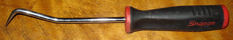

Originally Posted by Minnewaska View Post
Any tricks to getting a waste hose off that you might want to use again?
I've found a radiator hose pick useful - it can be used to loosen up a stuck hose and also to align a hose you are putting on the won't quite go. BTW, does anyone know where to get inch and a half hose grip pliers? The largest I've ever found is inch and a quarter.
