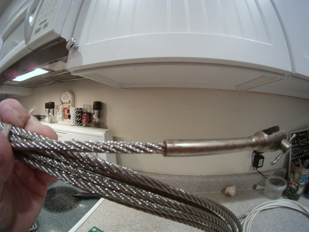

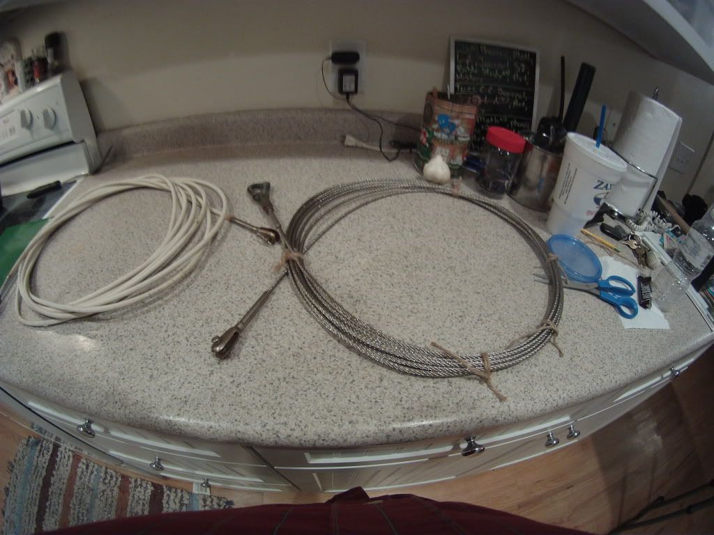

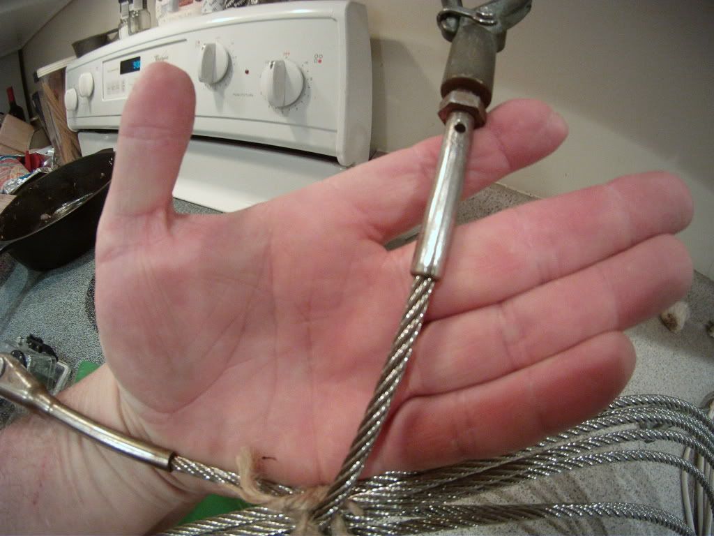

Here are a few shots after 3 hours of cleaning one wire of the vinyl. The wire under looks not too bad? I am comitted now one way or a nother I have to do somthing. I will shave the 2nd ont tomorow and see what it looks like.
I have a question? If after inspection I see no or verry little rust can I cut one end off opposite the pelican hooks andf add a turnbuckle so i can adjust it tighter?

Is that a crack in the end of the swage fitting in the second picture?
My experience is like others have said. They rust inside the swage fitting and look fine until one day they break right where the wire leaves the swage.

There is no cracks in the fittings at all . This stuff is 3/16 & X 19 SS wire. If it looks good with no cracks can it not be reused? It sounds like the conciseness is to throw it out whither its good or not? The ends will be cut off for the installation of turn buckles and a complete inspection of the wire at the fitting can be done.
Ya'll have almost convinced me to toss them out and use rope.
