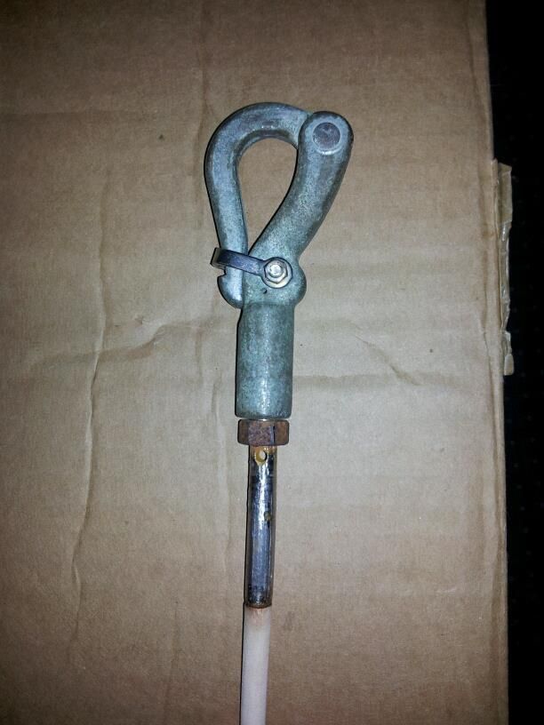

I have pulled the life lines with the vinyl cover off the boat. I want to go with SS 3/16" 7X19 but where should I have them made? West Marine? Should I buy the cable from West Marine and use the crimp style ends? My pelican hooks look to be in good condition. the photos below were taken with my phone. See if you can tell what I have and if the end can be re-used. Thanks again for your help in advance.
[IMG]Photobucket[/IMG]
And the other end is
Photobucket

The pelican hooks are dead. They're also inherently the weakest point in the rig so it's a no brainer. Replace everything including turnbuckles. Go with uncoated wire. In your photos, who ever did them, did a bad job - the vinyl never goes all the way the the swage - there should be a 1/8" gap. Do not do it yourself - this is an area where you should not try to save money.
I used riggingonly.com. They're great and fairly priced. Send them old ones and a week or two later shiny new ones will arrive.
