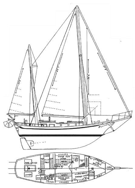

The Bill Garden design Formosa 41 originally had quite a radically raked mainmast ... looks like up to 7 degrees of rake on the 'spec'. drawings. Many of such radically mast raked boats from that era now usually have their masts 'straight up' for 'sail/helm balance' considerations ... and if now carried more 'straight-up' will radically/directly change the boom angle.
So first, the pregnant question becomes, how much rake do you normally carry in that main mast? That approx. rake angle will be needed before I can give a reasonable 'guestimate' reply and one based on generalized 'sailmakers data' for the F41.
Not exactly sure how to measure rake to be honest, but I got a lot! Weather helm and balance be damned, it sure looks cool! I'd say my rake is in line with the line drawings, so lets call it 7 degrees

.... What is the luff length of the sail (my data book omits the F41)?
I=47 J=16 P=42 E=17 PY=24 EY=11
