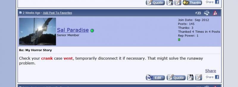

Hey Glad to hear! quite a few of us were saying that on the last thread, not just me but its great to be right for once..
I do remember this advice however the YSM8 manual shows no picture of the proper rotation. Also, the piece fits PERFECTLY either way. So even if we pulled it and checked we would have seen it looked "good" and just stuck it back on- bc why would we think any different? The hole is the diameter of the BASE of a pen TIP (not a pen, the tip).
It was one of those things that you just had to have seen it before to know. But you guys were right about the culprit. I just dont think without that guy calling and actually telling us to try flipping it over it would have made a difference. I wish I had a pic to upload so you could see what I am talking about. Its insane. Why would they make it to fit both ways perfectly?
