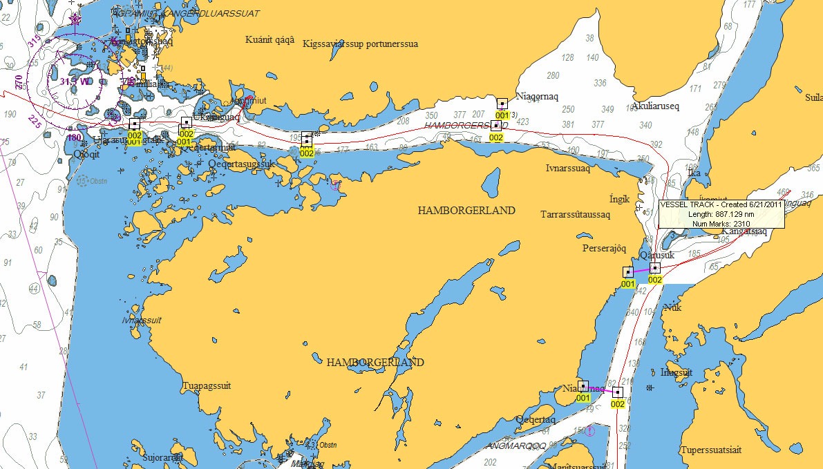

Onboard Morgan’s Cloud one of the biggest changes is that we now have electronic charting for the first time while voyaging in Greenland. And so far we have been able to navigate electronically, because C-Map has done an amazingly good job of correcting the datums (the original paper charts are off by as much as mile in places against the GPS).
However, there are still some spots where the datums are significantly off and we suspect that this discrepancy will only increase as we continue north. Since we have all the paper charts we aren’t worried, though we are a bit concerned about how rusty our ability to use the hand-bearing compass, parallel ruler and course protractor has become!
On this chart C-Map has done a very good job of correcting the amount that the datum of the original paper chart is off. However, the ranges shown are where we checked the distance to the shore to be sure.
What is worrying is how seductive electronic charting is: after using a plotter for just a little while it is extremely hard to believe that the picture on the computer screen is not reality! So we are constantly reminding each other that we have to regularly confirm our position relative to the land using radar ranges and bearings, which are reality.
http://www.morganscloud.com/2011/07/...ion-greenland/
