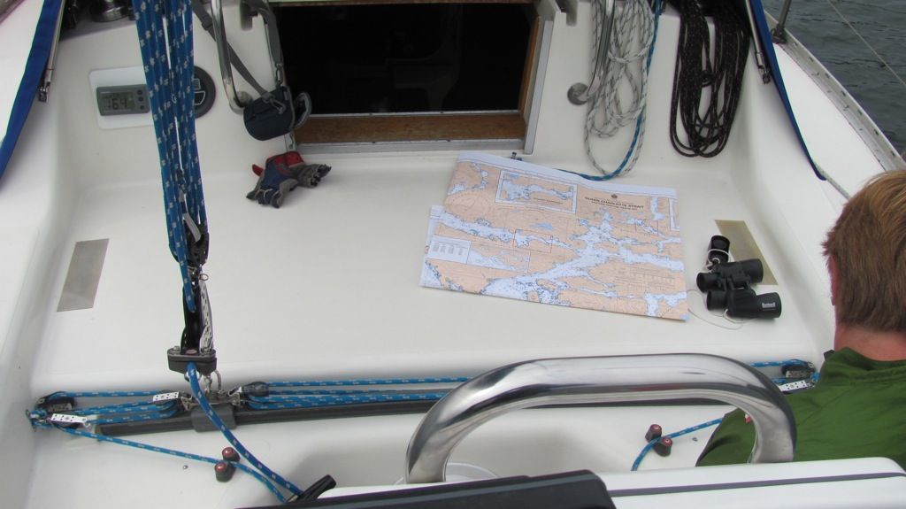

Moving it aft to the wheel should work, but sometimes there's no solid structure to work with.. ie cockpit seat hatches may preclude a proper traveler attachment.. so it will depend on the cockpit design. A short traveler might be added between the seats but that's reduction in effectiveness, though a good, powerful vang can offset that somewhat.
Ours is on our bridge deck, but it's very large and I can reach the sheet from the helm position.
It's also a good chart table for having real paper handy to read...
