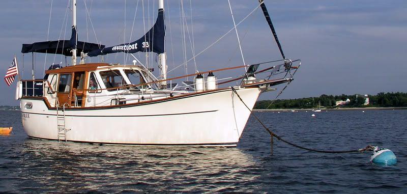

Since we stay docked at a marina and rarely spend more than a week at a mooring, this isn't really a problem. However, the friend's mooring we normally use has twin leads - which we run through chocks on the port/starboard bow. The angle of the lines falls well enough below our anchor and stays clear of the bobstay as well.
This photo was taken yesterday and since it was just for one night, I didn't bother attching the port side line. But, it does illustrate the advantage of a double line - a design we will use when installing our own.

Yes it is. Here's the same mooring while rafting up with friends - showing the double line in use:

Two Seperate pennants
Originally Posted by TrueBlue View Post
Valiente,
TB,
For a permanent mooring setup I'd recommend that you use two seperate pennants.
In the picture of the split single, it sure looks like a six foot chop, or the tacking motion of the boat in heavy wind (assuimg she sails on a mooring or anchor in a breeze) would cause the bobstay to chafe the lines. My boat has been on a mooring for the last seven years and its pretty gut wrenching to see the frantic up-down, back-forth motion boats develop when you get 50 knots for a day or so... looks sort like one of those mechanical bucking broncos set on fast...
