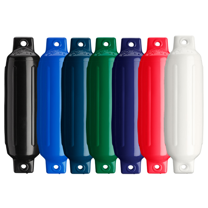

Oh, the longish one is better called sausage type. Sounds good. Easy enough to imagine. Any opinion on UV quality of Dan Fenders and Polyform F2 Fenders? Both sausage type.
