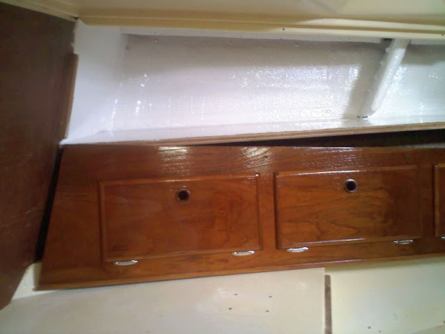

Painting inside of Hull
I started painting the inside of the hull using a good quality semi-gloss white oil paint. I'm not talking about the bilge but the area under the berths on either side of the cabin. This area is below the exterior water line. I'm starting to second guess myself and I'm wondering if this kind of paint is OK for the job I'm doing. Any comments appreciated.

I finished the job with the oil paint. Looks a lot better. I'm won't get my boat launched now until next spring so I won't know how it's going to stand up until the end of the 2010 season. Thanks for all your advice. I bought this boat knowing absolutely nothing but by the time it's finished, I'll know just enough to be considerably dangerous. Thanks again
