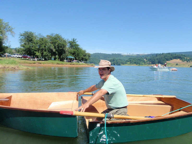

Both halves will float independently, I can even be in them, and assemble or disassemble them in the water.

Oh yeah, and the cutting it in half took quite a bit of psyching up, and few beers when it was over. Felt like I needed one before, but I did NOT want to mess it up! I just figured hey, if I goof it up, I can always build another one
