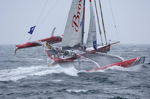

One major issue in favor of tillers is the simplicity of the system. A tiller is far less maintenance and far less complex. Also, many sailors feel that a tiller steered boat gives the sailor more feedback than a wheel-steered boat. Tillers can be used on even very large boats, given that they are designed for it. One of my favorite large trimarans is tiller steered and comes in at 18 meters long... seen below:

A question Dog;
If monohulls have one rudder and sometimes two (like mine) and Catamarrans have two rudders, how many rudders does a Trimarran have? In the picture you posted I see the windward amas has what looks like a rudder but could be a fixed fin. Also see the windward daggerboard is retracted but not the rudder or fin. Would a tiller on a Trimarran operate all three rudders at once? Just curious because I am not familiar with trimarran designs.

Looks like a fixed fin to me on the windward hull. Steering mechanism appears to connect only to the rudder on the main hull.

Wow! Wonderful photo, Dog. It took me a moment or two to orient myself and locate the steersman!

Knowing very well that I'm not as knowledgeable as the Dog on Tri's, I'll just say that the ama's (the floats) are typically not built to support a rudder, also it would defeat the purpose of the tri to heel so much as to have the rudder out of the water (for longer periods). Cats are a different breed, obviously.
