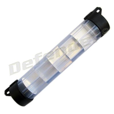

Another radar reflector?
I had an old fold-able Davis style reflector, but it has pretty much fallen apart beyond repair so I want a new one.
I really don't want to spend mucho $$$ on something like the Tri Lens that has such great reviews. I like the tube style reflectors by Plastimo & Mobri. I have not been able to find much about them? Are they decent? Other suggestions...

The Tri-Lens that WM is selling is a very different unit. It is a much larger, far more effective unit than the plastimo 2" or 4" reflector tubes. BTW, the Plastimo tube reflectors generally do fairly poorly in tests... and the best bang for the buck is usually the Davis Echomaster type reflector.
The trilens looks like this:
The Plastimos look like this:
Not the same thing at all.

Yea, I know what they look like. I have been trying to compare them but I haven't been able to find that PS review...I liked the easy install and lightweight of the Plastimo but was unsure of its ability to reflect well based on its design...I don't much care for the fold-able ones like I had (Davis), so maybe I bite the bullet and go with something such as the Tri Lens?
