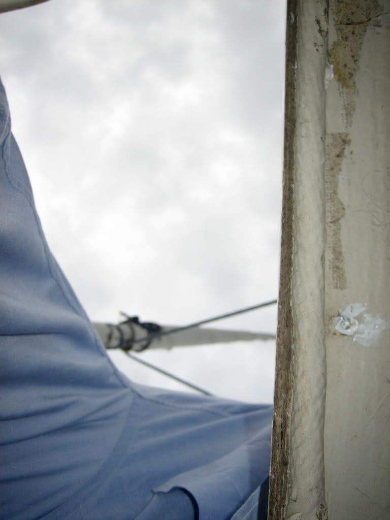

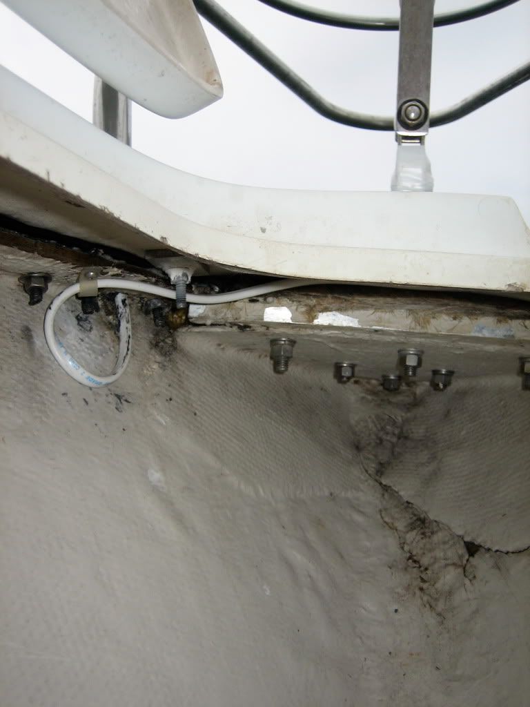

I am throwing down the gauntlet here by showing what i did today to re-wire my bow position lights:
..yeah, that's my armpit. Holes filled where clips were screwed into the balsa, not pure fiberglass.
marine-grade wires looped down (to let water to fall into the anchor locker) and out of the way, with clips that fit the wires, and screwed into fiberglass (not the balsa). The previous wires were spliced 3 times in a 4-foot length and the wires were leftover speaker wires, not marine-grade tinned wire (thanks 1982 C&C company workers; yes you know who you are, because I had to chisel gel-coat away from half the screws just to get them off).
