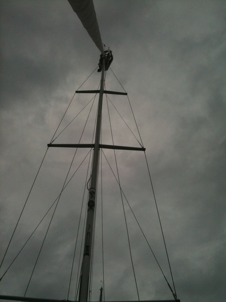

A bad day up the mast

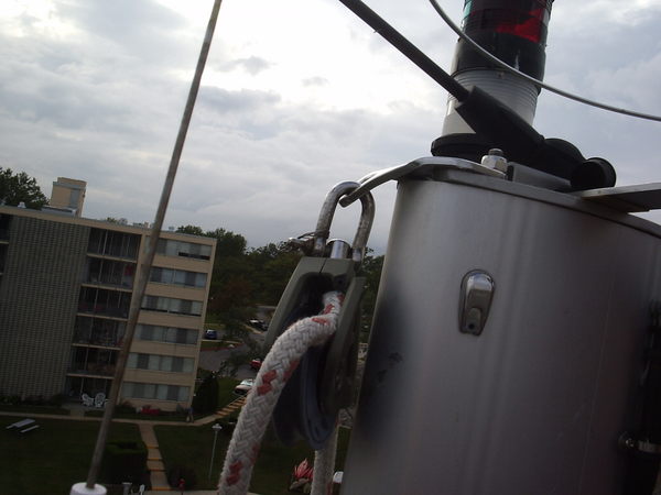

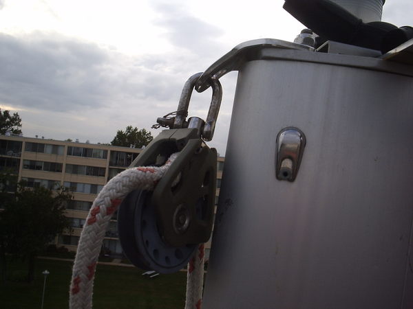

Earlier this week captainrizzo dropped by to help me go up the mast for some minor work. About three feet from the masthead (65ish feet off the water) I watched the block I was going up on coming apart. This is not something you want to see happen to your lifeline. Thanks to captainrizzo of Domingoman and Forbes of S/V Java (who heard the noise of the block breaking and came right over) for getting me back down safely on another halyard.
A few days later Dan and Jaye (wingNwing) of S/V Cinderella took me back up to replace the block.
This was more adventure than I really wanted.
sail fast and eat well, dave
