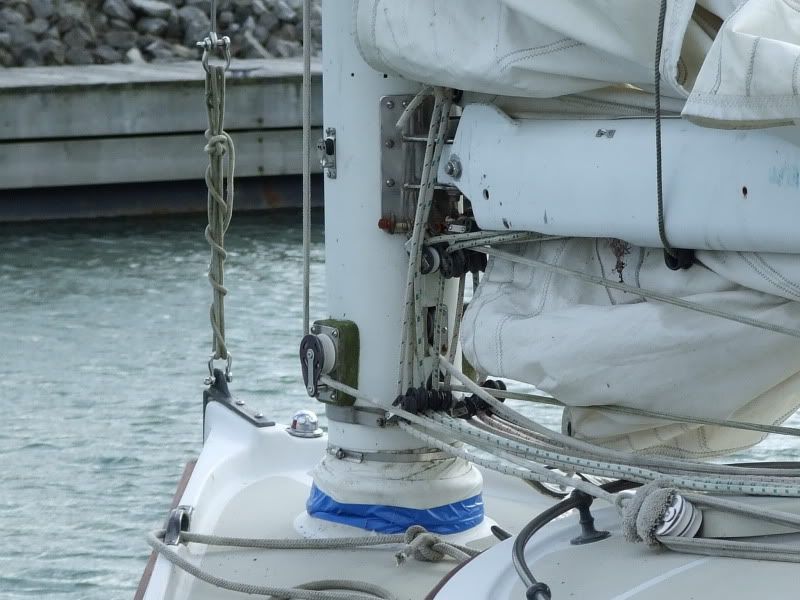

Of course, things can get kind of extreme:
Here's the clutch farm on a bluejacket 23, a catboat:
It's 5 o'clock somewhere:

Well, considering the boat has 34 years of use with just a line led to a winch and tied off on a cleat...(no cam, clam, or clutch) anything I add will be a bonus...
I think I will run the second halyard down and back to cockpit (parallel to first halyard)
I'll add a pair of cams, pre-winch, and then an additional cleat, post winch, to tie off on and back up the cam(s)...One longer halyard and I'm good to go...
Then down the line (time wise) I can add the clutchs, pre-cam, as cash flow allows....
