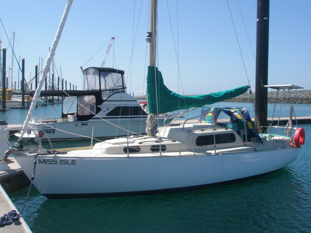

Originally Posted by ReefMagnet View Post
Woo hoo now I got 10 posts I can post a picture
Hey reef what kind of boat is that?
16' mistral sailboat, And 27' coronado
