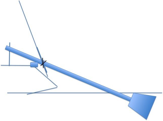

Originally Posted by rugosa View Post
Considering it is a plan for a 'typical' boat, it works on the drawing board. Designing for specific boat use would no doubt improve the execution. Denise makes a good point about long term tiller steering fatigue. Looks like the pivot point between "tiller" and "rudder" is off on this plan, that would cause early operator fatigue. Fine tuning will need to consider steering through the stern rail, above the pedestal, it's doable. When you consider the "emergency" tillers supplied by builders, this is more realistic, especially for anyone going beyond the site of land.
I like this. Good part of the discussion. Learning

For discussion:
This was the setup that passed a race committee requirement for an emergency steering setup. The plan was to ubolt a pre drilled lift-out board from the V berth to the end of the spinn pole, lash it to the backstay with some kind of chafe protection and either use it as a tiller, or lash the other end to the top of the wheel (if still serviceable). This was built, assembled, installed for trial but never actually put to the test... what'd'ya think?
I think on that passage, an NFL linebacker would be ready to drop from exhaustion after about 3 hours of attempting to steer a fin-keeled boat DDW in 25+ knots and 12-15' seas using such a rig...
Did anyone look at the link I provided to the passage made by the Sweden 390 EGRET above? A boat remarkably similar in design to a CS 36? They completed a passage of 2200 NM, the last 1500 of it without a freakin' rudder, in only 26 days... Hit their intended destination right on the nose, an absolute textbook example of how it should be done...
Tradewinds poled-out twin headsails and a drogue, people... Let the BOAT do the work, for chrissakes... (grin)

I have skimmed the thread.
ISAF offshore rules require an emergency rudder. Install gudgeons on the transom and have a rudder with pintles to match stowed on board.
The spin pole rudder will work. Some friends in the 2000 Vic Maui sailed 600 miles on one. I brought the boat back with a rebuilt stainless rudder.
