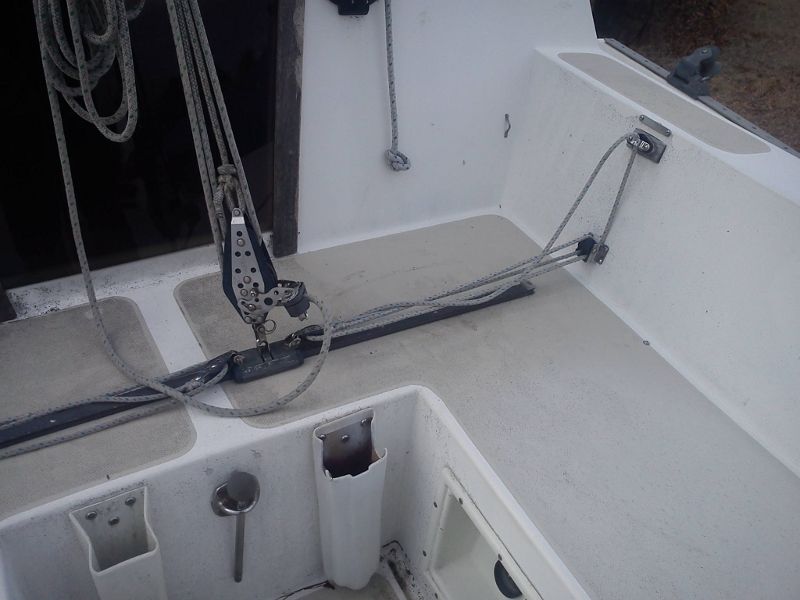

Why don't you just try it? it looks like tying your main sheet block to the ring is a 30 second affair. Just check how that ring is mounted first.
Originally Posted by scratchee View Post
Here's a picture of my traveler (I think...hopefully there's a picture down there.)
That block on the side of the cockpit (the seatback) is all messed up, and moving the traveler basically requires sliding it over by hand, and feeding the line as it goes. So my first thought was to replace the blocks. I also considered some other solutions that might make the whole thing work easier while reducing the footprint, for example blocks at the ends of the track.
But now I'm thinking about taking the whole thing off, including the track, and securing the mainsheet to that ring between the winch handle pockets (holding the transmission lever in the photo.) My typical sail shaping is somewhat rudimentary, just tightening here and there to make the luff and the telltales look right. I don't do any racing and will rarely get more than 25 miles from home (which means, never leaving the Chesapeake.) I'm almost exclusively weekend sailing. To be honest, the most important thing I do with the traveler is get the sheet out of the way of the companionway.
On the other hand, just pinning the sheet in the center would open up some seating options in the cockpit, and would keep things simple.
Unless there's some major performance issue I'm not aware of, the biggest potential drawback might be a future buyer who is disappointed that the boat doesn't have a traveler.
I'd love to hear some opinions. Will I not point as well? Can good use of the boom vang make up for a stationary mainsheet? Under what scenario would I regret not having a traveler?

You could also install a padeye on the cockpit sole. We used a fixed Wichard for our sheet, but a folding eye would be less underfoot. It would serve for your mainsheet experiment, plus additional harness tie-in. Or a place to clip water bottles. Always nice to have more clip points on a boat. If your traveler setup stinks, you won't use it. If you don't use it, better off to have a fixed mainsheet.
It's nice if you can decouple boom downforce from sheeting angle, which is what a traveler does for you, but lots of people get by w/out. Dumping the mainsheet during gusts on larger boats is simply not feasible. Way too much force. On small boats, we have that option. As someone notes above, tho, easing the main actually increases sail draft, and then your leech twists off & starts flogging. At that point, probably best to reef the main & steer to the puffs.

Just my opinion. If it was my boat I would do it the way Denise030 shows. Exactly that way.
You'll be able to keep the traveler sheet in your hand if you are sailing in heavy weather to dump the sail all while trimming back the main. Also, just for the "light air" sailing benefit alone, keep and use a traveler. Also, it disperses the load and makes trimming the sail easier.
If you never want to worry about it again, and maintain some of the re-sale value, buy a brand new traveler set up like in Denise030's picture. If you do that, see if you can measure the existing holes and see if Garhuer or whoever is making it can get that template or something close, therefore installing it would be easier.
I understand the argument to simplify and that it'll sail without the traveler, but every time you get frustrated because your sailboat isn't performing or cooperating like it should, you'll regret 'making things simpler'
Also, I would not allow the load pressure from a mainsheet to pull on that little two-bolt ring.
