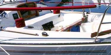

Leaning against a lifeline???"
Well, there you go - yet another example of a MOB situation that could likely have been averted with a modicum of common sense, and knowing how to move about a boat properly...
Never ceases to amaze me, how common those freakin' lifeline 'cushions' have become today... One of the most dangerous things one can put on a boat, IMO... Even while anchored or at the dock, I can only shake my head whenever I see lifelines around the cockpit being used, literally, as a backrest... an incredibly piss-poor practice...
I was thinking that as well and I am new to sailboats
