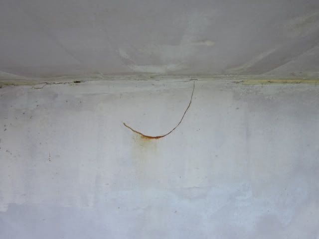

Wow, thanks! I knew about the bottom paint, but you reminded my of the keel!!! I[IMG][/IMG] will have to research it and do something about that

Looks like you are ready for a grind down to bare metal, eoxy the keel then paint. I woudl get prices in Canada, and down where you are. potentially getting it done local ie canada.

Yeah thanks for the reminder... I had not had time to look at sailnet these last few years but the resources and wisdom online is great and I began looking again. I've got a few leads. I'm not worried about the grinding or the fairing afterwards as I've done part of the keel a few years ago and it still looks flawless. But I got to get my head around the issue of barrier coat, which I'm learning about...

I was just through this in the spring. I only removed the loose parts of the barrier coat on the keel, visible through cracks or rust. When shining metal appears on the keel, you are done. Rinse with acetone. Then the first two layers of barrier coat. I used VC-TAR2, because I use VC 17 as fairing. Do this in sections, so that new rust does not get formed while you are working your way round. Then a good deal of West expoxy filling. Then 8 more coatings of barrier on the keel, five layers on the hull.
It sounds easy, but it is a lot of work. The look is highly rewarding, though.
