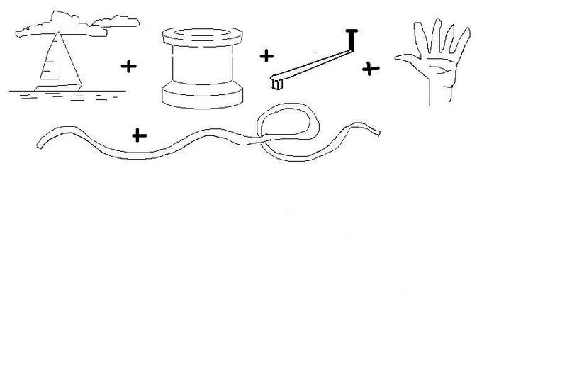

OK...here's some help with the aid of some hi-tech engineering schematics...
First let’s look at options and resources available....
Careful examination of elements bellow, allow us to conclude the "ingredients" necessary to obtain successful. Results at sheeting in a winch…
Observe for at least 2 minutes the elements bellow:
Then once observed, lets start with our project…remember…the objective….to sheet in….
Problem…how to combine all the above elements, in order to successfully obtain our goal??? Which is????…..sheeting in….Good....
Please arrange objects above in correct order to achieve goal….
There you go....
VERY GOOD…..
