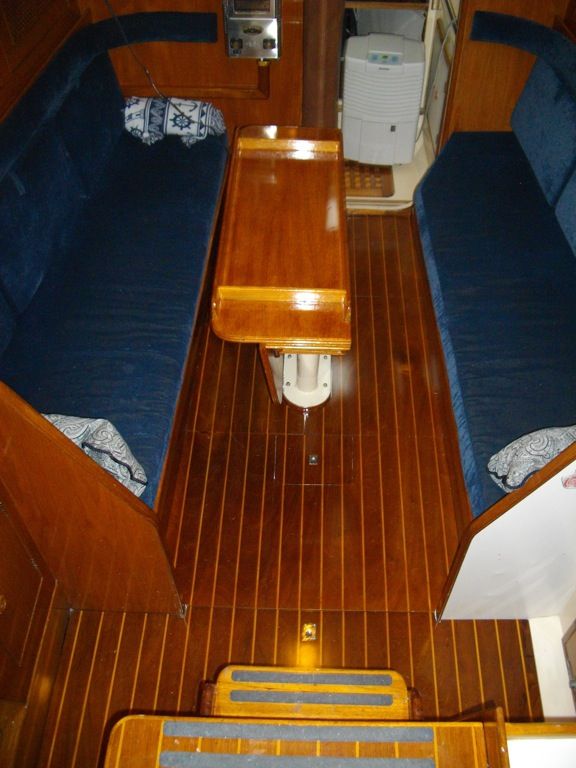

Dsully... my wife is an accomplished seamstress and quilter with excellent equipment and she chose not to do this herself.. but that's her.. I think the scale of the project and our living in a condo were factors.
The microfleece was recommended precisely because spills clean up easily without staining if you get on it right away. The cushions are nearly 8 years old now.
This pic when they were recent:
This pic was taken a week or so back..
jameswilson29 likes this.

Thanks... the material I used was Royal navy cotton duck... just like sunbrella fabric only not waterproof but much softer and much cheaper ($7.00/yd compared to $21/yd for sunbrella)... you can buy this material at any fabric store... the foam was bought there as well only it was a little more expensive than what could have been bought at Walmart... it took me about two weeks to put everything together (most of the time was spent having the foam in sterilization to kill any mold spores and make them like new after wash and dry) ... they came out great and clean smelling!
Faster... your salon looks great... although looking at your cushions they don't have many curves and look square, mine had many curves and angles... was a bear but they turned out great... +1 on the velcro.... makes them easy to work with and they'll last forever... they are also adjustable to remove wrinkles in the fabric... my cushions are very tight without looseness or wrinkles. Everyone comments on how great they look!

Thanks for posting pics of your salon. It really is lovely inside. What kind of boat do you have? I love the blue material you chose. It's so pretty with the wood inside. Your boat appears to be in very good condition. The boat we're buying is older (a 1983 S2-11C) and the salon is fairly dark inside, so we decided to go with white to lighten up the space. Well, it's good to know that your wife decided to go with a seamstress to do this work...that makes me think probably I should go that route as well. Especially since I'm NOT real talented at sewing. I can pretty much do anything I set my mind to do, but don't know if it's worth the hassle this time. I want it to look good, too, and it may not if I do it. Thanks again for the pics. I enjoyed looking.

Lovely blue fabric. A dacron inner wrap will help plump them up.
