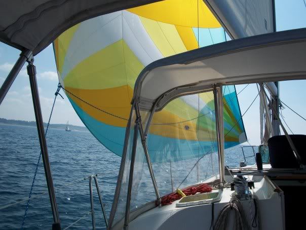

It should be run back to the cockpit some how; first for safety reasons and second for ease of trim. I suddenly became aware of this myself just a couple of weeks ago when I purchased an A-symmetrical. I don't have the same boat, but the thinking is the same.
I attached a swivel / block to my anchor roller as far forward as possible.
Than simply ran that back to the cockpit via the organizer and than through the clutch. I have one winch on the cabin top that I use.
It is my understanding that in a near broach or in a possible broach scenario, that you want to be able to release the tack; that the tack is the first thing that gets blown. I have not experienced anything like that, I am just telling you what I have been told. If it’s on the foredeck or if it’s fixed you are not going to have this option.
I also play with the adjustment of ours. Bring it down and tight for close/beam reaching (we have a gennaker and I am surprised at how angles we can actually fill the sail) and we let it out and up when the wind angles get flatter.
I think you will want to be able to control it and adjust it back at the cockpit. I just run it along the deck from the bow back with a simple swivel attached to the anchor roller.

Some photo's,
hope you can see the tack line...
1) eased out fuller luff
2) a little tighter playing with sail shape
In this shot you can see the clutches and winch.
Although not a PS, I think the concept is the same.
Courtney is My Hero
