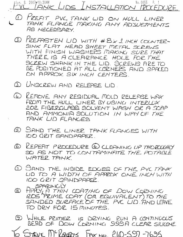

Replacing Water Tank Lids
Sorry to bring up tanks once again, but......
Does anyone still have a copy of the handwritten instructions from the factory for replacing the tank lids?
It used to be located here: http://www.sail-talisman.com/project...structions.gif, but seems to be gone now. I have misplaced my copy and would really appreciate having them.

Brian:

Awesome. Thanks for the quick reply.
