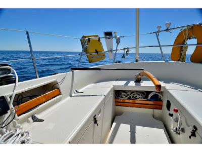

Dave:
Here is a C34 for sale up in Milwaukee w/tiller:
Regards,
Ted
V42#186
s/v Little Wing

Thanks Ted. Great picture. Looks like an original install. I've already moved the controls. They're nearer the bilge pump than in the picture. It was NOT an easy job. Knowing what I know now, I'm not sure I would put them there again. I think PSC's retrofit position (stbd aft in a separate box) would have been easier and not required as big a hole in the cockpit.
