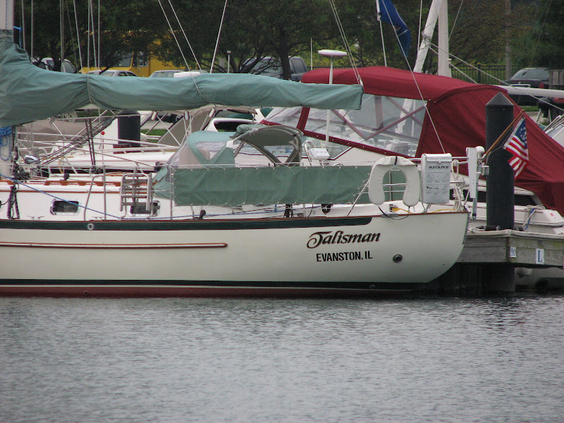

SC:
The balance point seemed to us to be a few feet abaft the mid ships cleat.
You can see it below by the forward gate stanchion:
We found that the t track mounted Schaefer cleats worked great for docking. And as they're adjustable, you can fine tune that balance point.
