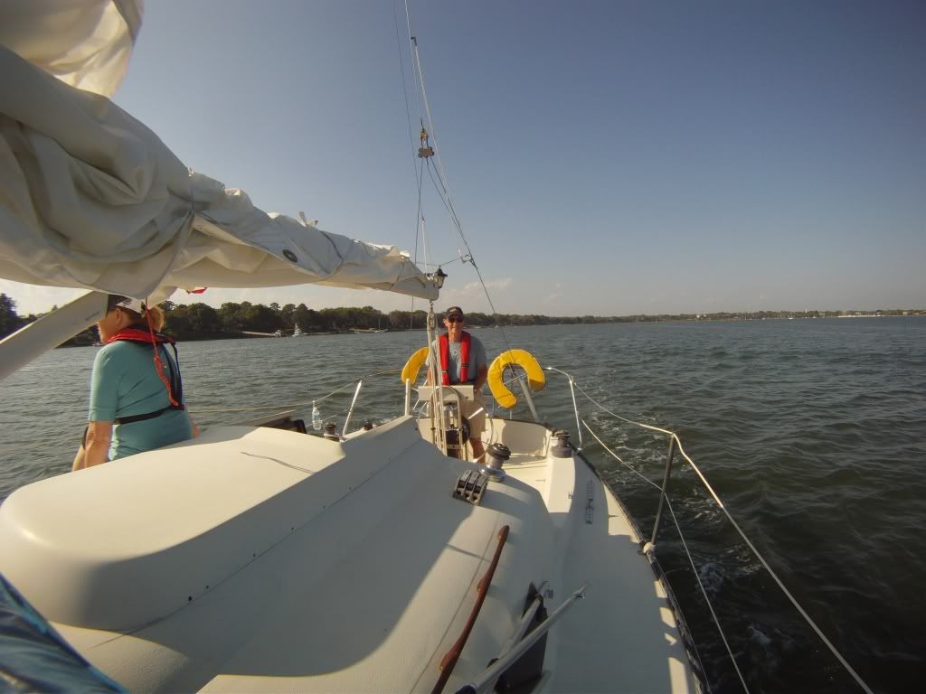

Yes, there is a track on both sides just before the wenches. They are like 30" or so long. there is an adjustable slider that can be locked down were ever you want to lock it. I will try to find a photo. Seams like the standing rigging and the safetylines will cause a restriction in the movement.
I will look for a photo.

That track is far aft, maybe the former owner only raced in light air, that short track may only fit a large jib, maybe a 170% or a 150% with a high clew. If the 150% is your primary use sail, hopefully it'll trim OK to that track.
When you want to start improving higher wind performance, you need to install a similar track aft the chain plates for a smaller jib, someone on the C&C list should have the factory location diagram for that track (I had it 30 years ago, but stuff wasnt digital then...). until then, whenever you use a small jib you will be pointing some 10 degrees or so less than optimum.
