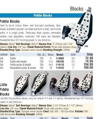

Harken's 060 hexaratchet fiddle block (bottom right in the pic below) should fit the bill....
Edit: sorry to cut off the prices.. it's listed at $133 in the West Marine catalogue.
Thanks, Ron - that looks like the gadget I'm after. It's listed at $149 on the Harken site - West Marine must have it discounted.
I know I can get a 2nd-hand Ronstan ratchet for a slab of beer from one of the guys in the club and that would leave me with at least 100 bucks in my pocket... but:
