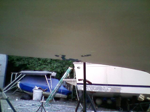

I would love to say a solid hull did fine BUT that was NOT the case This 1970 C&C 35 had custom keel that was wraped and glassed and the hull was BEEFED-UP to take the new loads (naval architect no DIY)
The keel to hull joint did not even chip the piant BUT the hull failed about 2' behind the keel and it was a HUGE repiar

Originally Posted by tommays View Post
Well
Tom,
I saw this pic in another thread and meant toask you then. What exactly are we looking at ? I don't get it. Did she run aground and that is the damage shown or am I missing something ?

Tom,
that's where the keel hit...he doesn't appear to have a photo of where the hull was torn from this impact.

looks worse than it was
big area of damage at the blue paint well behind the keel
Its the LEAD keel on Zzzoom which dinged a rock at 7 knots healed at about 15 degrees
When the PO owned the boat he hired Britton Chance to do several keels a modern double spreader rig and rudder years back
The C&C 35 I has no sump or bilge to speak of for that matter
The new keel was much deeper 7' and a shorter mounting footprint so to take the load and support the mast which NO longer had the BIG original keel under it
They really beefed up the hull and it never had and issues with the smile UNTIL the rock and it had no smile after the rock
The lead did not yield at the hull at ALL
Small amount of hull damage forward and aft of the keel
Massive damage 2' behind the keel were the hull was finally weak enough to yield to the massive force involved
