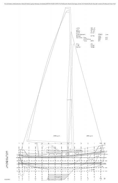

Outbound: Here is the sail plan that goes with the hull. All of the vital statistics appear on the upper right corner. They never format right on when I cut and paste them but here there are.
LOA 32'- 2"
LWL 29'-10"
Beam 9'- 8"
Draft 5'-10"
Displacement 12,563 Lbs.
Ballast 5,775 Lbs.
Sail Area Main 399 S.F.
100% fore 255 S.F.
Total 654 S.F.
D/L 212
L/B 3.08
SA/D 19.36

Jeff:
You should reduce the size of the masthead crane. It's way too big. Use a 6" headboard on the mainsail.
The spreaders are too low. I'd go with double spreaders for sure. Have the lowest panel be the longest. Show a little kick up angle to the spreaders. Angle should bisect the stay angle or get close to it so you don't put a bending moment on the spreader.
Rig looks too tall for me. I'd like to see I, J, E and P on the drawing. Maybe drop P and I to get a SA/D of 18.2 max. It's nice to have power but this rig height looks out of proportion to me.

Defer to the master ?but with that high aspect and a tunable backstay looks like she would go to weather like a son of a gun. ?Don't lose that. Maybe a 7/8th rig and double spreaders wouldn't destroy the aesethic.
I am not trying to speak for Bob on this, but for myself I have to admit that some of the design inspiration has been the four decades of mulling over how I would improve the 1949 Folkboat that I owned in the 1970's, and my last two boats that have had almost this identical rig.
This is strictly my opinon, but here goes, while double (or more)spreader rigs make sense on race boats, really big boats, and boats which are dependent on overlapping headsails, they do not make much sense on cruising boats. Double spreader rigs are much harder to tune and maintain, with more parts to fail. In my mind, cruising boats should be simple and reliable. The main advantage of a double spreader rig is allowing a narrower shroud base, and/or a smaller mast section. If the design is arranged so that the boat does not need to use larger overlapping (the shrouds) headsails, the spreaders can be wide enough to get plenty of mast support without double spreaders and the boat will be a better cruising boat.
Upwind performance should be okay, but this is actually a rig which should really reach very well as well. The boat would probably benefit from a masthead chute, but would be a lot easier to handle with a chute that had its halyard a couple feet above the jibstay, and that is probably how I would rig her. I would also have spectra running backstays that would only rig in extremely heavy conditions when reefed.
Bob may have other ideas on this which I would enjoy hearing.
