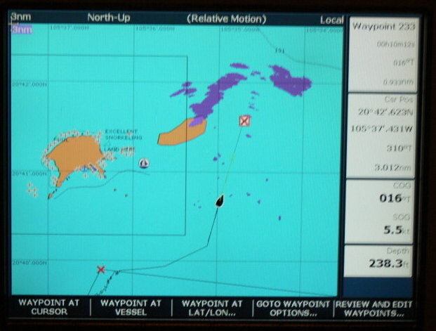

Going into a new port at night, you may be safe relying on the GPS for navigation, but it is a good idea to back it up with visual markers or, at a minimum, radar.
Last year I was coming up to the Marieta Islands near Puerto Vallarta sometime before daylight. Several miles out, I noticed that the radar showed the island over a mile in the wrong place. I thought the radar might be broken.
I slowed down to arrive after dawn. (You can see the jags in the boat track at the bottom of the screen where we were floating around.) It turned out that the GPS data (Navtech) and the admiralty charts show the islands more than a mile off their true position. I am glad I noticed this sooner rather than later, because the shore is rather rocky.
Marietas Islands, west of Puerto Vallarta
The Rains' Boating Guide to Mexico shows the islands in the correct place.

Bob, could that have been chart datum error? GPS and Admiralty charts using different chart datums? Or GPS and radar not being set to use the same display, i.e. DD.MM.mm versus DD.MM.SS perhaps?

Actually GPS has shown a number of smaller islands to have been historically mis-plotted. Most of these are now fairly well known and charts have been updated.
I'd point out via Bob's excellent example that, when it comes to cartography, GPS, and visual/radar navigation the visual/radar is to be assumed the most trustworthy. The value of the coastal chart is not in it's precise correlation of terrestial masses with an accurate latitude and longitude but in the accurate depiction of their relative locations. In simpler terms, once landfall is made latitude and longitude cease to be of great navigational significance. The island is exactly where you see it as being, either visually or on radar, regardless of whatever the discrepancies may be in assigned latitude and longitude. Perhaps the best correlation may be made with the fathometer, or depth sounder, versus the charted depth. Which are you to believe? (After all, cartographers and surveyors have off days also!)
Ignoring the effects of radar super refraction, which manifest themselves only at very long ranges, usually within a temperature inversion, the radar is to be trusted above the GPS. I'd have been inclined to think, were I in a similar circumstance, that the GPS was "broken" not the radar.
If I'm reading your display correctly, and there is some doubt in my mind as to that, the error is on the order of minutes not seconds, ie.. miles off. Are there more islands off screen that I'm not seeing and what is the nature of the topography of the islands. I'm having trouble resolving the two images I'm seeing as being the same-but then, I guess that's the whole point, eh? (g)
The datum (WGS84 vs. NAD27, for example) usually only makes a couple hundred feet difference, and the electronic chart "informs" the chart plotter of its datum. The radar and GPS were set correctly, as they aligned properly before and after visiting the Mariatas with no change in settings. Also, the land was where the GPS claimed it was before and after visiting the Marietas.
If you compare the charts (electronic and otherwise) with Rains's Mexico Guide, you can see that there is a difference in the lat/lon between the two.
