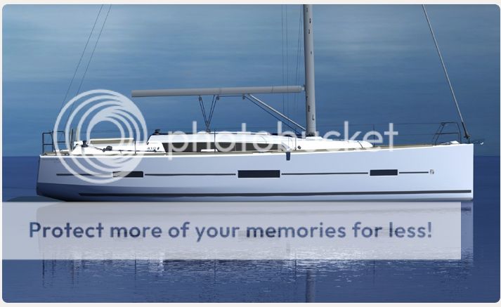

New boat: Dufour 410 Grand Large
Technical Characteristics:
LOA: 12,35 m
HL: 11,98 m
LWL: 11,15 m
Beam: 4,20 m
Displ.: 9430 kg
Ball: 2600kg
Draft: 2,10 m
Fuel Tankage: 200 l
Engine: 30 cv
Main: 38 mq
Genoa: 33 mq
.................................................................COMMENTS?

Like in the D36P, I like everything I SEE in the new D410, but it needs to shed weight. Thanks for posting!. I thought they would come out with a Performance 40' first. Looked at their website, and it seems they are also launching a new 380GL and a 450 GL.
LOA: 12,35 m
HL: 11,98 m
LWL: 11,15 m
Beam: 4,20 m
Displ.: 9430 kg
Ball: 2600kg
Draft: 2,10 m
Fuel Tankage: 200 l
Engine: 30 cv
Main: 38 mq
Genoa: 33 mq
I like much of what Dufour has been doing, but even among the recent crop of plumb stemmed boats I find these boats particularly 'boxy' in profile.. not exactly pretty.. I think the sheer must be more parallel to the DWL than most others....
I like the overall design (graphically speaking) even if I prefer boats less beamier. But I understand the concept in what regards to having a more stable platform and a boat that heels less for the average cruiser that wants his boat mostly to sail downwind and will not sail with a head on wind. After all the vast majority of cruisers motor on those conditions, so yes, this boat makes sense. The boat was bettered in that respect in what regards the previous model, the 405. This one is considerably more beamy (4.20 to 3.98m) and has all beam brought back.
This is, as the last Dufour a Felci design so I have no doubt that it is an efficient and well designed boat for what it is intended to do but I fail to understand why the previous boat weighted 8 990kg and this one 9 430kg. Weight certainly is not an advantage and serves no purpose. Maybe the bigger volume of this boat? Anyway I don't like that extra weight.
Like on the previous model I don't like the B/D ratio of this boat, that is on the low side: 27.5%. I know that it is a bit better than the one of the 405 and this boat has more draft (2.10 for 2.03). This two factors and a substantially bigger beam will give it a bigger RM compared with the previous model, but than it is needed because the boat will have more wave drag and more wet area (more heavier).
I did not saw the keel design but I don't believe that it will be less modern than on the previous model and then we are talking about a torpedo keel with all the ballast down. That will give to this boat a sufficient AVS, but I like boats with a bigger part of its stability coming from the ballast. This boat will sail well, I am sure, in almost all conditions, except close against the wind in a blow were the power needed to overcome the waves and the added wave drag will not be probably enough for a good speed. The boat will heel and the ballast will not be able to give him that extra pull to cope well with those conditions.
Other mass productions boats will do better on those conditions.
Regarding the sail area I don't understand also why the previous boat that was 560kg lighter and had less have drag had more sail upwind (81.90m2 to 71.0m2). That is a big difference and hardly understandable since this boat has more RM and can therefore carry more sail.
A jeanneau 409, that has a better B/D ratio (30%), less beam (3.99m) and weights 1980kg less has more 7m2 of sail and I am not talking about the performance version but about the standard one.
I guess the infusion process is responsible for that big weight difference, but I really don't see how the Dufour 410 can compete with the jeanneau 409, that seems just a better sailing boat. I have also looked recently to other boats on this class and remember that the Hanse 415 has a performance almost as good as the one from the Jeanneau.
The Hanse 415 is, in what regards the hull more similar to the Dufour, both boats have a similar beam and the Hanse is even heavier, weighting more 530kg but it has a much better B/D ratio (32.5%), having a bigger RM and carries more 16m2 of sail and that is a lot.
So I guess I don't like very much the Dufour in what likes its general sailing picture.
Regarding the interior it is a bit risky to talk only about designs but I would say that it seems nice, following the general tendency of a polivalent chart table but I don't like the galley. I mean, it seems big enough but will not offer any support for the back, so I guess that on that one if on the sea you will have to tack the boat to the right side, or maybe the boat heels so little than that it would not be necessary, especially because the boat really only heels hard when pressed against the wind and again, the ones that are going to do buy this boat will not do that (or they have chosen the wrong boat) and therefore all is well:D
Re: Dufour 410 Grand Large
Paulo, that assesment is spot on - we chartered a 405 last summer in the Med for a week. Not much fun over 20 knots upwind, especially with a building sea. Sail reduction becomes an urgent thing; we did 20 miles to windward just a mile off the Turkish coast into a gusty sou-wester (28-35 knots). At a reasonable angle of heel in lively seas that's a long way (to fall) between the 2 wheels with not a lot to hang onto apart from the wheel. Undersized genoa winches didn't help either. The flat bow sections just pounded as there was never enough speed available that close to the wind :rolleyes:
The 405 (and presumably the 410) certainly do what they're primarily designed for - easy family coastal cruising and as a living platform at anchor in a beautiful cove it does it quite well. A nice stable downwind boat but our inshore upwind experience showed that "coastal cruiser" is not a genre of vessel which can happily ignore that scenario - often coastal weather conditions can be more severe that offshore in terms of wave / sea state, and proximity to a leeward shore is always on one's mind :eek:
Some particular points about these latest Dufours (our 405 was delivered new in early 2012) - this charter operator almost exclusively uses them (mainly 375's and smaller) - the shore crew are a useful source of feedback after a few beers ! hull moulding, gel coat, non-skid etc very good and our boat still looked brand new in that respect.
Down below was a different matter - notwithstanding the additional wear & tear a charter yacht gets, the finishes already looked 3 years old with veneers worn thru, chipping & peeling in all the vulnerable places. Locker catches breaking regularly etc. Halogen lighting was quite sophisticated and useful but electrical charging systems were a problem on our boat and others too, with limited Dufour support for a solution.
Volume in the main saloon is BIG - and not a place to be upwind in rough weather !
One other fitting which had been removed is the standard transom platform recessed swim ladder which are quite flimsy and apparently only last a matter of months; so are replaced by a more substantial ladder bolted to the stbd side of the transom - not a great look but works well.
Of course this is all in context that these boats don't cost much money in the relative scheme of things - apparently our 405 had been bought new with all gear by the charter company for EUR150k. It seems Dufour were also doing great deals on 2 cabin 375's as they'd mis-calculated demand for that configuration and keen to clear the stock.
If one accepts that these yachts are primarily designed with warm weather charter in mind, then maybe they're a good blend of requirements for the price.
One other observation about cruising boats where the max beam dimension is at the stern : for med style stern-to berthing, esp when you're going for a space which is only just wide enough (and some cross wind) it's not ideal to be leading with your max beam (esp two square corners which can't easily be fendered). Much easier to slip into one of these slots with max beam further forward !
Discussion starter · #3,159 · (Edited)
Boats are designed for a certain purpose and one designed specifically for blue-water in rough seas would be a very disagreeable one to to live and sail in the conditions we sail most of the time.
I find your opinion about the boat to harsh:). Certainly I agree in what you say regarding going upwind with some substantial wind and waves, but out of those conditions and in the conditions the owners of those boats use them (that are also the conditions we use our boats also most of the time), the boat would out perform most of the boats that are very good in harsh conditions, boats designed specifically for those conditions.
Regarding charter, well, that is just a terrible thing to do to a boat:D. But yes, I have been also sailing on a Dufour 425 with some months and the boat just looked vandalized and probably was;). I agree with you that Dufours have nice interiors but not very resistant to an harsh and not careful use but in that regard to that are not worse than most mass production boats. At least they look nice when they are new:D
Faster, I think that Dufour interior has improved a lot in what regards design quality but in what regards type of boat I still prefer the old 40 performance to any 40 of their line, the 410 or the 40e, so if I can say that I like their improvement in design quality I cannot say the same in what regards type of boat, particularly in what regards B/D ratio.
Off course the old hull and keel could be improved by the new developments in design and some of that difference in B/D ratio is lessened by a more efficient keel/ballast, but not all.
The older D40 performance had 3.90m of beam, weighted 7800kg and had a B/D of 36%. The new 40e has about the same beam, weights 7950kg and has a 30% of B/D ratio.
The boat is better designed in what regards hull design (transom), keel and the overall performance will be slightly better around the cans but in what regards the conditions that have been described (upwind with waves) and as a bluewater boat with good coastal abilities, the old design was just better. It had more rocker, a much bigger B/D ratio and in what regards cruising the differences in speed would be really small.
For the guys that are looking for a 5 to 8 years old 40ft cruiser at a very good price the "old" Dufour 40 performance is one of the best options, at least in my opinion.
