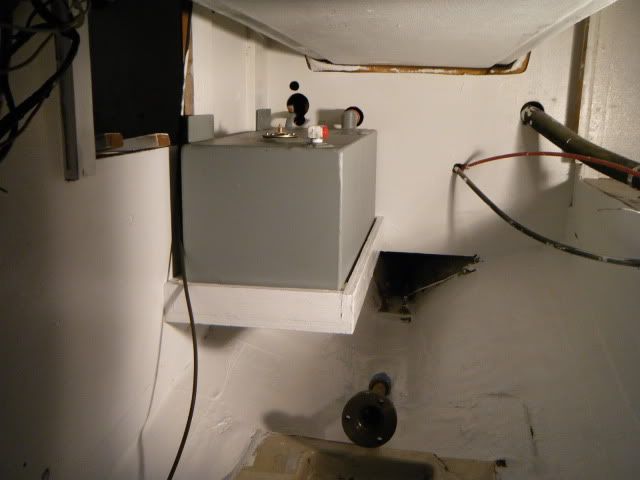

In my normal polite manner i have to say
I find it hard to believe some of you have pulled a motor out of a sailboat
Cleaned up the 40 year mess
You could not possibly have bought many parts form Moyer as i was into over a 1000 dollars for a much more minor rebuild
And doing a complete tear-down is a ***** with the integrated transmission
And then left the boat in a reasonably professional manner
1970 Cal 29 Sea Fever

Two thumbs up - didn't that feel great when you lit that thing for the first time in that spotless engine compartment?
I'll bet it cost a whole lot less than the 5 figures a diesel swap would have cost as well.
