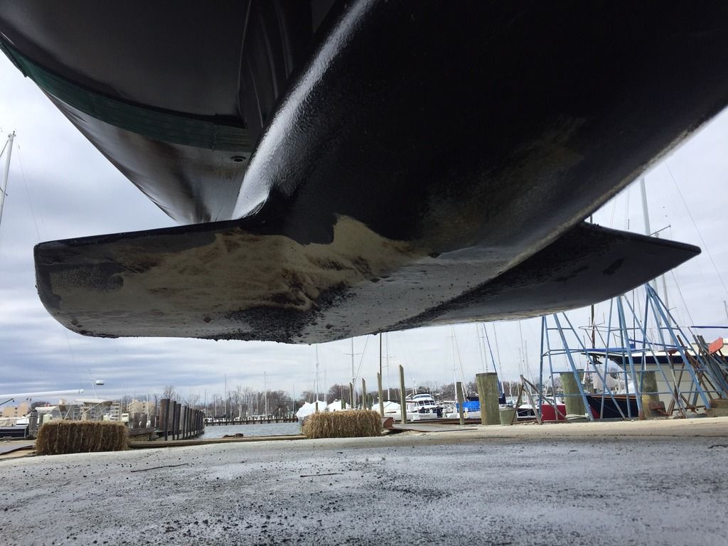

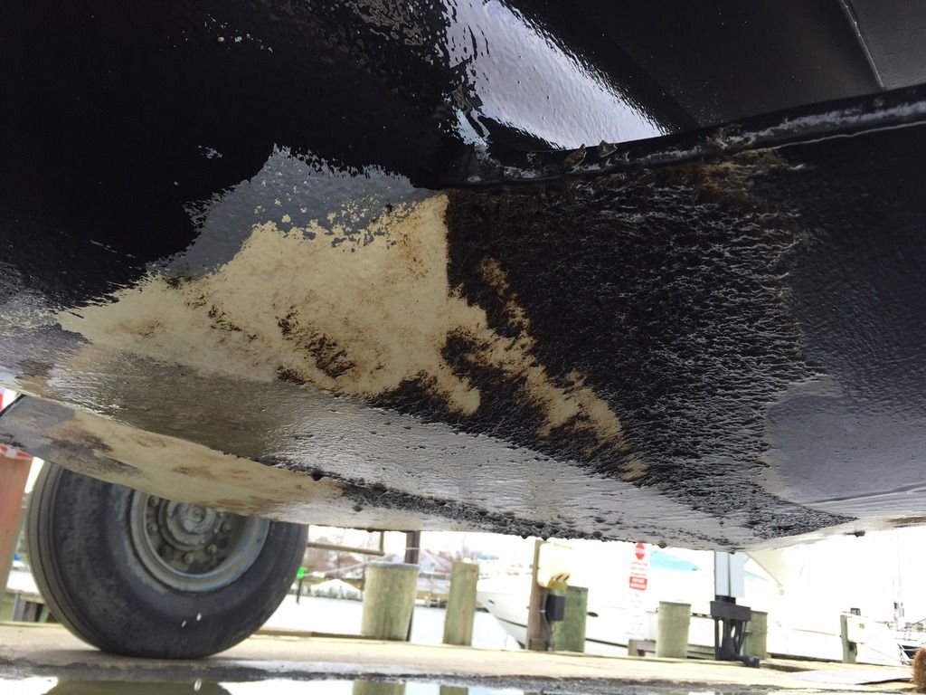

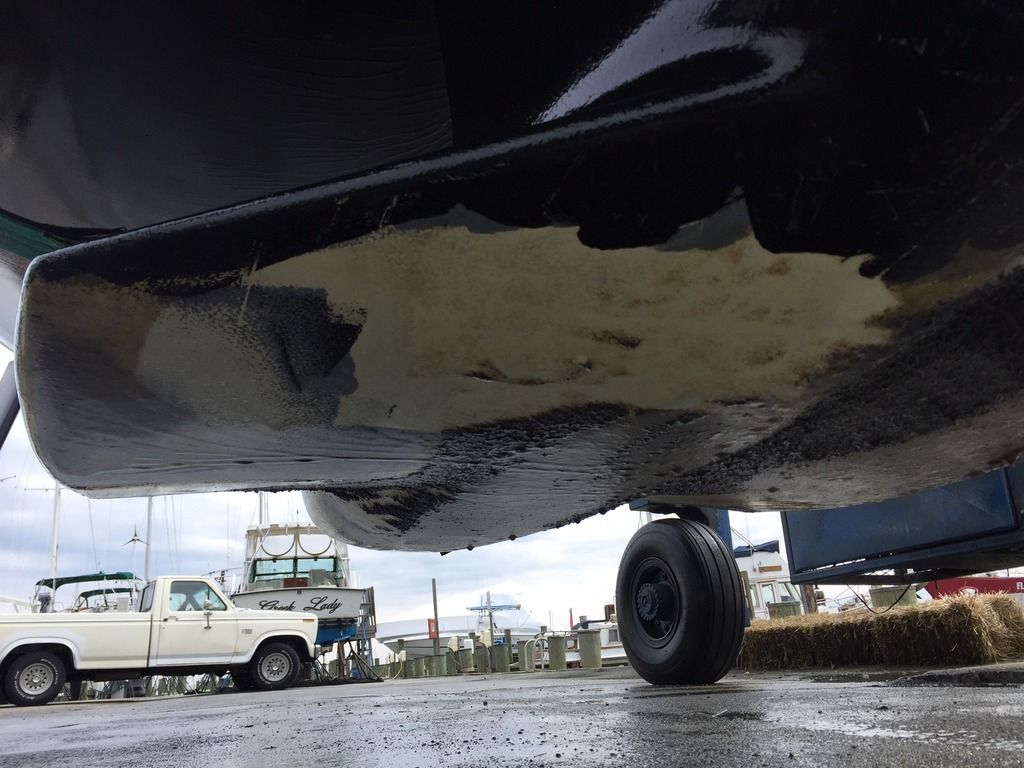

I know it's a bit of a tricky thing to do but I would assume dealer commissioning new boats do their best to paint the underside of the keel. Well, I hauled out today for a quick pressure wash to get her ready for spring and below is what I saw. Should I ***** about it or is that business as usual?

Given that you can see patches of grey primer alongside the bare keel itself - I'd say that's just sloppy.
My boat goes back in tomorrow and for sure there'll be a guy standing right next to it armed with a tin of antifoul and a paintbrush ready to get to work the moment she's lifted in the slings.. or the yard will know all about it.
She looks like a beauty - good luck with her. :)

Thanks. I like to be reasonable but don't like to get cheated either...
If you point it out to them nicely, they'll likely just fix it on the spot at no cost to you..
It's really not a big deal - but, yes, it needs to be done and it's reasonable to ask them to do it.
