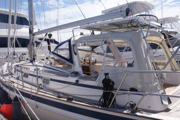

Currently our solar panels are mounted in a frame over the cockpit. Keeps the cockpit nicely shaded but limits the number of panels, blocks view up to the mainsail and shading from the boom is probably effecting the panels performance.
I'd like to put an arch on the stern which would allow us to increase the number of panels and unblock the view to the main. General shade for the cockpit can be easily sorted and we could then extend our boom cover back over the cockpit itself, whereas it now of course has to stop where the panels begin.
My big problem is how high above the windvane does the arch need to go so that the vane still operates properly ? Is it a practical idea to even consider it ? I really do not want to lose the vane (Hydrovane btw) if it can be avoided.

Ref the arch my only concern is making sure the airflow around the vane is not detrimentally effected by the arch and the panels. That I presume will be determined by how high the arch is off the deck.
This is a pic of our current setup.

You have any pics of the aforementioned setup ? Looking at your profile pic it's a bit hard to tell what is going on back there but it seems similar to what I'm thinking of. Wind genny doesn't pose any problems ? How much solar do you carry ?
Our radar and wind genny are on the stern so I'm also wondering whether or not the radar at least would be better located on the mast.
