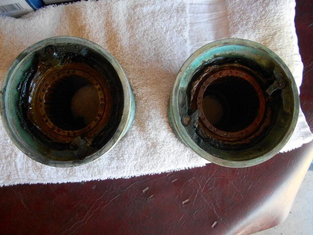

I posted recently about two new (to me) winches that I planned on adding to the doghouse. I thought it pertinent to pull the winches that were on the boat for maintenance. What I found was not pleasant. It looks like the PO used bearing grease in the originals, and they are completely gummed up.
Question: What can I use to clean/remove all this grease? I don't yet know if these are even salvageable until I get all this 30 year old grease off.

From the picture I can't see any reason why they cannot be used again. Better to see lots of grease in them rather than none. You can clean them up with a bunch of paper towels and some solvent (whatever you have or this is cheap to buy. I would do one at a time so you can use the other as a model for reassembly. Take them apart - just looks like pawls and one or two roller bearings for each. Be careful with the springs on the pawls, when you take them out they have a tendency to shoot all over. Since they are all greasy best to avoid the mess. Clean off as much of the old goop as possible with paper towels and then wipe, or soak everything in solvent and then more paper towels until they are clean and you can't feel any grit when you roll the bearings. Also clean the inside of the winch drum. When everything is nice and clean lube the bearings with winch grease and the pawls with oil only and reassemble. On some winches the winch springs have different shapes on either leg. If you have these make sure they go back the right way. On other winches it does not matter which leg goes where.

Actually I have seen worse. The easy way is to soda blast the inside clean which will take a few minutes but requires the right equipment. The normal way is to grab some kerosene, rags, and a brush and go at it. It will take a while but isn't hard.

We used to see bicycle free wheels that looked like that. We had a parts washer in which we used a citrus based solvent. We used a citrus based solvent because it really worked dissolving old grease, was water soluble, had a nice smell and was not flammable.

I use mineral spirits. Kerosene and diesel work well, but my local hardware store just had mineral spirits. An old toothbrush is useful, as is a wooden popsicle stick for getting in to the gears. Careful with the toothbrush - they splash!
You can never be sure from photos, but I have seen and cleaned much worse, and put 'em back into service. They look fine. Remember, grease the gearing - but oil the pawls. Grease on pawls make them stick. Which would be bad.

those are fine...the key is to male sure the pawls dont stick from the old grease and that you respring them or rextend them if you will
I just did all my winches the quick and easy way basically with a solvent soaked rag and a screwdriver scraping off all the old dried grease
I used a lithium based waterproof grease that I used on my motorcycle and works great
again the key is getting the bearing races free and clean as well as the pawls...as well as the gears

Replace the pawls - springs too probably. Use a brass brush on the roller bearings - they must be bright & shiny - keep working until they are.
Try soaking them overnight or longer in brake cleaner.
Polish up the races inside the drums with some 1000 grit and WD40 or kerosene.

I cant remeber how mine looked...but Im almost sure they were flat all around...
I just rebent the springs out a bit and that will give them more resistance...I usually do that on all mechanical engine springs and the like...
or just buy new ones since you are getting new pawls...
I would soak those races and then mechanically clean them up and or polish
looking good btw...
those winches will be back in business in no time...
