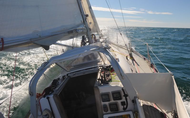

In my opinion, you absolutely need to have the control line run back to a cleat or clutch at the cockpit, to make it easily adjustable to suit the conditions… My brake is the yellow line, below…
I've come to favor the use of a line with a bit more stretch over time, seems a bit easier to control, but it does require a bit more fine tuning/continuous adjustment…
The Dutchman is a nice piece of gear, but has one major drawback, in addition to being rather heavy. If you stow your mainsail in a conventionally flaked fashion, draped over the boom, you might get a real issue with chafe against the rather sharp edges of the top of the brake… I resolved this issue somewhat by fitting a sort of 'drape' from elkhide, that lays over the top of the brake, but not before I had done some minor damage to a 3DL main, not good :) Even with the protection I've added, it still requires a sharp eye from time to time… One advantage to the Wichard, with its much more rounded shape, that sort of chafe would not seem to be nearly as much of an issue…
You can sort of make out the protection I've fashioned in this pic, and you can see I have the control lines stowed inboard near the chainplates, rather than out at the rail, where they would be if I were sailing downwind…
