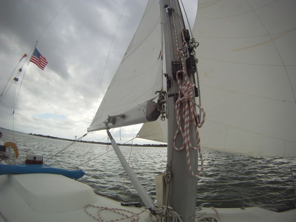

An alternative that is even cheaper to is to make your topping lift out of very light dyneema line (1/8" or smaller, 2mm stuff is good but harder to splice). It can be a fixed length about 12 to 18" shorter than your main's leech with a fixed very lightweight block at the end (<20 grams). Run a line from the end of the boom up to that block and then to a control point.
This lightweight topping lift will blow out of the way of the main in even the tiniest breeze. It costs about $40-50 total depending on your main sail size. There are two splices to make, but they are easy brummel splices in single braid. The dyneema is more than strong enough for the needs here.
You can see my topping lift blowing out between the leech of the sail and the backstay. You can also see that my mainsail could have a lot more roach, and the next one will.
I don't even adjust my topping lift very often. I leave it set like that so that when the main comes down the boom drops slightly until the topping lift goes taught. Occasionally in very light air I'll use the topping lift to avoid closing the mainsail leech and to keep shape in the sail.
