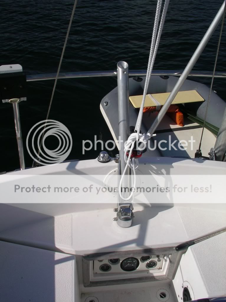

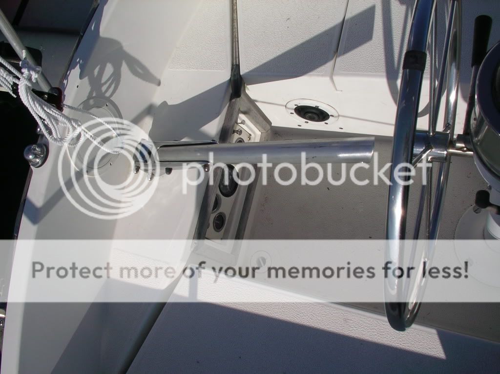

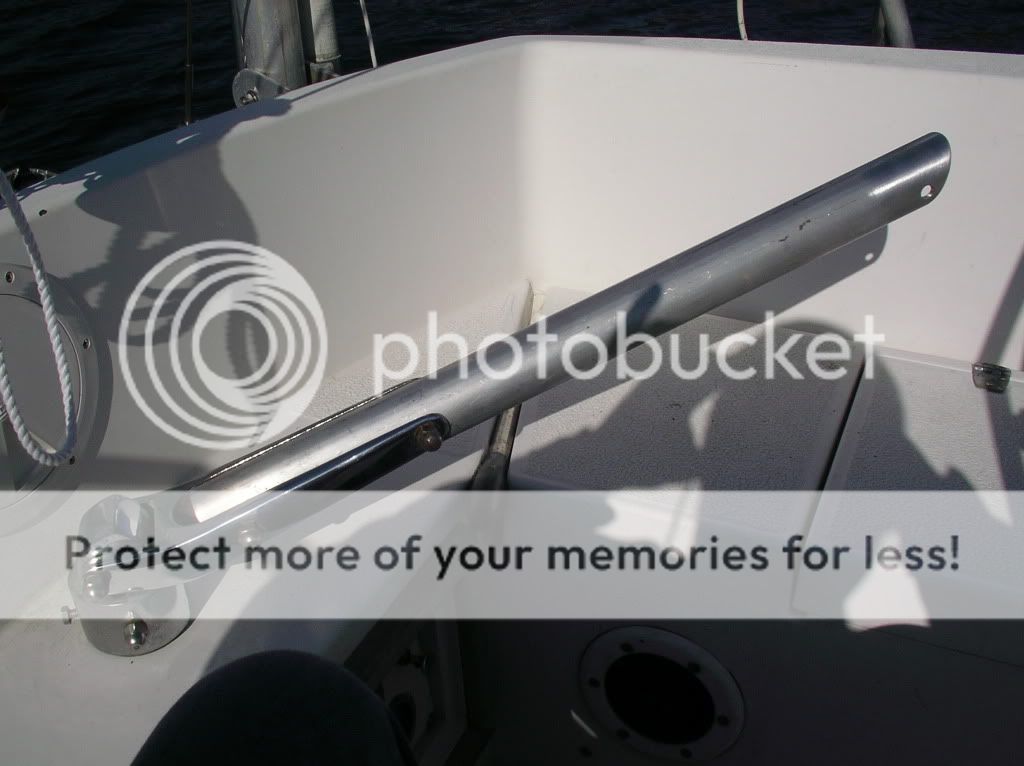

Mine came with a tiller and a po converted it. I have the original tiller, too. The short distance from the tiller post to the wheel is plenty of distance to attach an emergency tiller. I have mine there all the time standing straight up. The boat is so well balanced with its balanced spade rudder that I can steer with a couple of fingers on the "emergency" tiller. I like having it there and use it a lot. After getting away from busy water I can sit next to my wife and steer with the short tiller.
If you have the tiller end casting, or can get one it is a nice feature.
