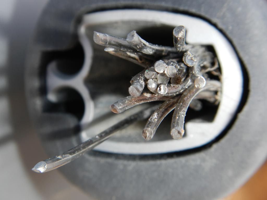

We reach Kos Marina after dark. The marina people are very nice and tell us to stay overnight on the Bavaria 54 - we'll figure things out the next day. The next day, the boat is taken to a yard and the mast is taken off. It is clear that the head stay parted right at the swage near the masthead. We talk to the base manager, but he just tells us to sit tight. We spend one more night on the Bavaria 54. Finally two days after the unfortunate event, we hear back from the charter company: the base manager has filed a report stating that we made a mistake that overloaded the head stay. The whole event is our fault and the company will not provide another boat. Fortunately we paid for extra insurance and we're not charged anything. A day after the event, the other two families returned to Kos Marina, so we embark on one of the boats and set off again. The remainder of the charter is uneventful and a lot of fun with winds in the high twenties, at one point hitting 38 knots.
Needless to say, the attitude of the charter company was very disappointing to us - I am not sure what we would/could have done differently and it is surprising to me that it is possible to dismast a sound Bavaria 42 in 22 knots of wind, sailing close-hauled (an accidental jibe is a different story). The maximum wind speed we clocked was about 22 knots, although one of our companion boats got 26 knots at some point. I took some pictures (below) of the head stay and it seems to me that the cable failed by fatigue, although it is difficult to know for sure without better micrographs. I have posted one of the pictures of the fracture site - it is clear to me that some of the strands in the cable failed in a ductile fashion because of overload, while others show a brittle fracture surface, possibly due to fatigue. Moreover several strands show clear signs of corrosion.
Head stay:
Failure site:
Floating without a mast:
Is this really our fault or is this a case of poor maintenance? If the latter, how do you prevent this from happening again? Is there anything I could have done differently? What lessons to learn? When I launched my own boat at the beginning of the season, I inspected the rigging very carefully and found several cracks in the swages - I immediately had all of the standing rigging replaced as I didn't want to lose my mast. Little did I know it was going to happen anyway, on a different boat.

I can't tell from the pictures, but it looks like there may be some corrosion on the wire fibers (dull areas) indicative of crevice corrosion, leading to a weakening of the whole segment.

Any more pictures - the other part of the headstay?

that wire does have rust stains as they probably trickled down from the SWAGED fitting up top...
most furlers these days recomend mechanical fitting and toggles both above and below.
however the individual wire strands look pretty good to my eye and decent...you have rust stains twirling around the stay but the individual wires look good.
not necessarily a wire issue. more than likely a twisting overloading and fatigue from maybe not enough movement on each axis.

It is interesting to me that it failed at the top swage. Isn't the bottom swage the more common site for failure owing to corrosion from increased salt exposure? Could repeated halyard wraps and winching have fatigued the stay over time? Is it possible to destroy a stay with a halyard wrap and winching??
