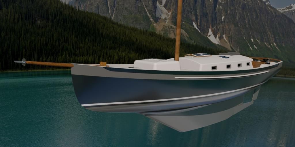

OR getting all bent out of shape about it now, 37 years later, doesn't alter anything. Time to move onto my latest project, the Four Carbon Cutters Project. One client, four custom boats.
