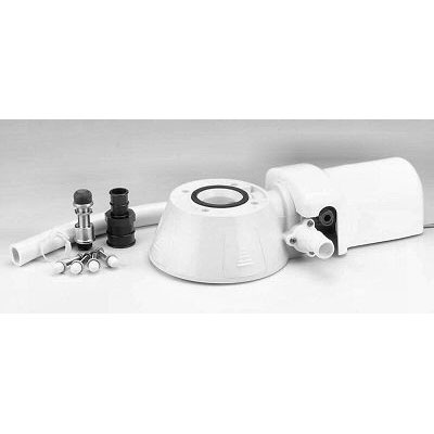

Like some, we have converted one of the heads on our boat to electric for the sake of simplicity and ease of use, primarily for my (much) better half and daughter but also for guests that are often unfamiliar with the operation of a marine head. Our conversion was made with the Jabsco kit below:
This device actually works quite well and has good endurance. Unfortunately though, we finally lost the impeller in the raw water intake chamber, which threw a vane (after 9 years, a pretty long service life, however). A rebuild is/was not difficult, nor particularly time consuming, but is inconvenient and especially so if one were on a cruise. And getting to the impeller is sufficiently difficult that one cannot readily swap it out as a routine maintenance operation as we do with the impellers on our engine, generator et al.
